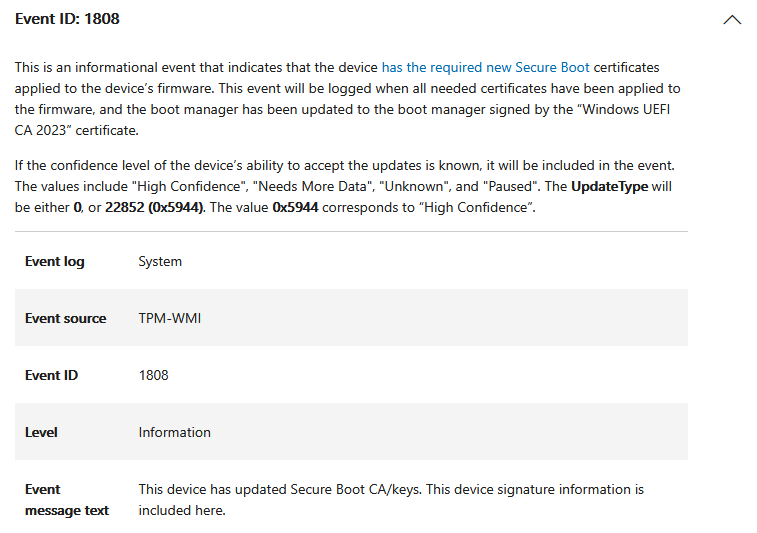

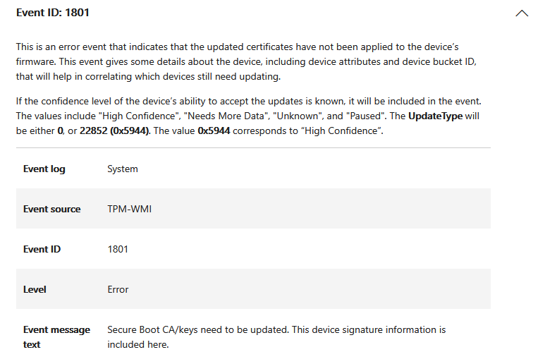

Before we get into the ways to update, Microsoft added additional events in Windows that you can use to track and confirm application of the updates. All of them are listed in this Microsoft article, but the two key ones are 1801 and 1808.
Here are two reports you can use to look report on all devices that have these events. It is important that for event 1808 you enable scanning informational events in your Lansweeper configuration first!
