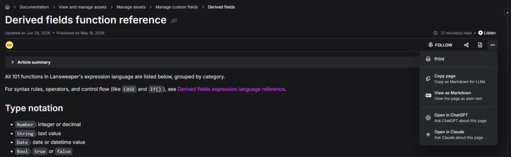

To get a full understanding I recommend taking a look at our derived fields documentation.

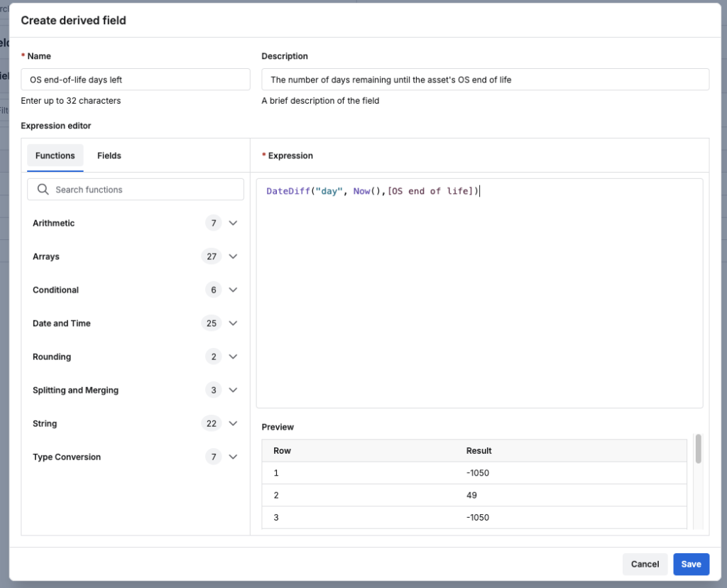

Once in the creation menu, provide a name, optional description and the expression you want to use.
An extra tip here is if you have access to an AI tool, feed it our derived field documentation and ask it to create expressions for you. It might not get the field reference correct, but the logic should be solid. Every KB article has a markdown version now too, making it even easier to use with AI.

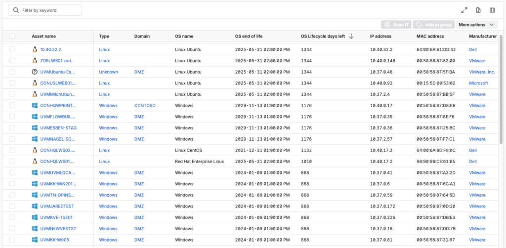

Days remaining
Lansweeper has multiple data points that are dates to keep an eye on. Whether its one of the multiple end of life dates or warranty. With a derived field you can easily turn it into a days remaining number that is easier to glance at and sort on.
Days remaining until OS end-of-life
DateDiff("day", Now(),[OS end of life])

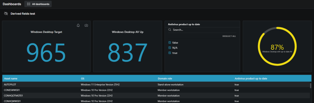

Creating a dynamic target on a dashboard
The Gauge widgets on dashboards can be really useful to display your progress towards a target. However, without derived fields its impossible to create a dynamic target. An example if this is how many of your workstations have an up-to-date Windows Defender?
For this we would two derived fields:
  1. The target we want to reach
  2. The current status
As a simple example I created a target of all Windows Desktop assets. And the current status being all Windows Desktop Assets with Defender being up-to-date. This can be used to many percent of my Windows desktop assets have Windows defender up-to-date.

As part of our solutions released in our marketplace, we have even more examples of this in both the Intune Coverage & Policy Status dashboard and the Tenable Coverage dashboards, although these require workflows to be configured and run first.
The bigger point is that anything using derived fields you can create a dynamic target to chase or track so that in a split second you’ll see whether there is an issue you need to look at more closely or not.
