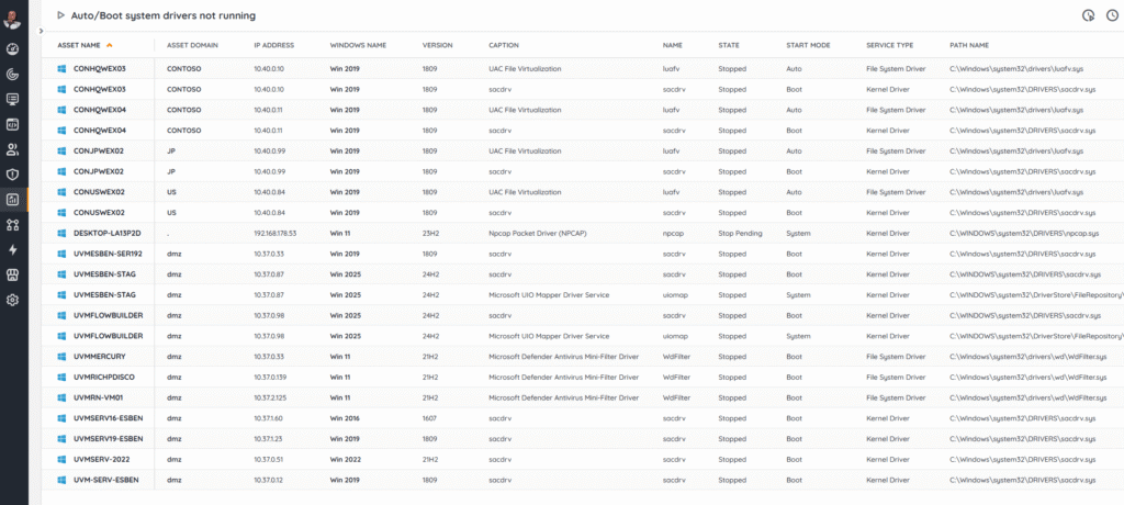

Auto/Boot system drivers not running
Auto/Boot drivers are meant to load early and automatically because they provide foundational OS functions (disk, network, security, encryption, monitoring) or enforce controls before users can interact with the system. If one of these drivers isn’t running, it often signals a hidden problem, corruption or missing files, a failed update, driver signing issues, policy conflicts, or even tampering/malware trying to disable protections. The risks range from stability and performance issues (for example a storage or NIC features missing) or security gaps (AV/EDR, firewall, or disk encryption not active at boot).
In short: Auto/Boot drivers not running can be an early warning that something in the startup chain is broken or has been interfered with and something you’ll want to have a look at.
Additionally, there is great potential here with our new upcoming feature that is currently in beta, flowbuilder, where you can create notifications, tickets in your ITSM product and more using this data. Something I’ll have to follow-up on when its available for everyone.
This report provides an overview of system drivers scanned in the last 7 days where the Start Mode is set to Boot, System, or Auto but the driver is not running.
I did exclude a few drivers that are designed to not run after boot (like WdBoot, hwpolicy, and dam) and you can adjust the report yourself to add more if you have them in your environment.
Auto/Boot System Drivers Not Running

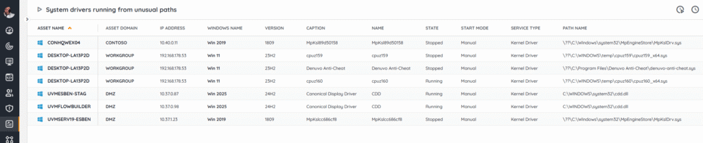

System drivers running from unusual paths
System drivers usually live in protected, well-known locations like %SystemRoot%\System32\drivers and %SystemRoot%\System32\DriverStore\ and to load through trusted mechanisms. Seeing one run from an unusual or user-writable path (Temp, Downloads, user profile, random ProgramData subfolders, network shares, removable media, or other locations) is a red flag. At best, its just some misconfiguration or sloppy packaging, but at worst, someone trying to sidestepping allow-lists, bypassing integrity checks, or hiding from your EDR tool. It might even be an indicator of a “bring-your-own-vulnerable-driver” (BYOVD) attacks that load malicious or outdated kernel drivers from non-standard locations.
Our report provides you an overview of system drivers scanned in the last 7 days that are not located in Windows\System32\Drivers\ or Windows\System32\DriverStore\
Again, if you find drivers you don’t think are an issue, there is room to simply exclude those from the report.
System Drivers Running From Unusual Paths
