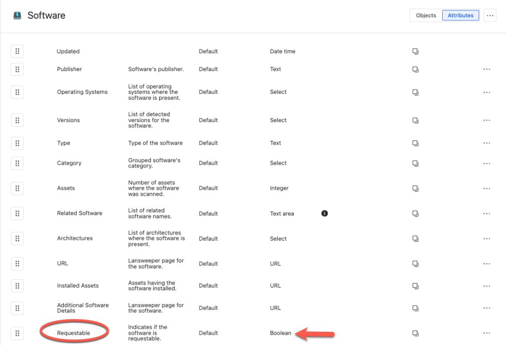

Step 1 Add a “Requestable” Attribute to your Software Object Type
Navigate to Assets → Object Schema and select your Lansweeper Software object type (you may have named it “Software,” “Installed Applications,” or similar, depending on your import). Then, add a new attribute:
Default Value: No
Type: Boolean (Yes/No)
Pro Tips 1
You’ve now defined a way to flag whether a software title should be visible in the service catalog or request forms.
